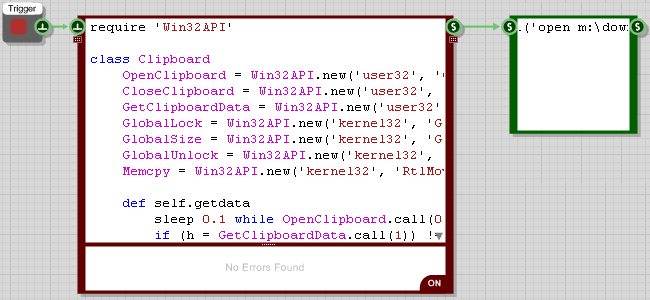

Paste.fsm- (659 Bytes) Downloaded 1218 times

Why isn't this working in my compiled EXE (v3.06/3.07) ???
I also added optional a WIN32OLE modul for a WMIC cmd... this even crashes the App/Exe...
Please HELP!
Please HELP!

fine - but why dosn't the clipboard only work in FS but not in my EXE
WIN32OLE is not a requirement to use WMIC.
I know but it pipe into clipboard

What are you trying to do exactly, paste text, bmp, audio ?
I possibly need a refresher!
I wrote this in 3.0.5 & haven't used it since.

I think this is from 3.0.5 and works when compiled in that version, what changed in 6 & 7 ? & Why???
"/C WMIC /Output:CLIPBOARD logicaldisk where "drivetype=3" get deviceid, volumename /FORMAT:CSV"
I just wanted to avoid the temp file creation and loading...
it works already with piping into file (as usual) in the Roaming folder but... not the fastest/secure way...
Keep on doing!
Walter
P.S.: Please contact malc because of this problem - thanks
