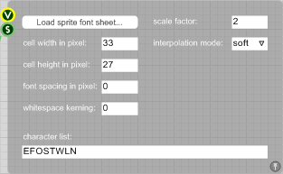

Here's a very, very early version of what I think will contribute greatly to proper GUI design. Currently you have to use a TrueType or OpenType font and can only hope that the user will have that font installed.
Most of the time you only have some labels which don't change, so you can substitute by using a bitmap of that labels. But what about changing displays, like the value of a knob or a rolling LED or something like that?
Sprite Font Engine aims to be a proper bitmapped font replacement for the system fonts. Whatever font you use with SFE, it will always be accessible (it is loaded with the dll or exe). You can rely on it.
It works by dividing each char of a font into sprites that are than arranged on a sheet. This is saved as a bitmap, and loaded into the engine. Next you provide the width and height of the cells and a list of all chars present in the font, in order of appearance.
EDIT: Each char needs at least a 1-pixel-full-transparent-border around it.

I don't have enough time to create a proper full ASCII set font. Currently the example fonts only contain the upper case letters needed to write the word "FLOWSTONE". I'm seeking for someone to create a font (A-Z, a-z, 0-9, the most used special signs, and if possible the german umlauts äÄöÖüÜ). If you are willing to help, just make sure you're not just copying/converting an existing font, but really create an original that can be bundled with SFE without license issues. Aim for a font that can be used as a general workhorse, no fancy flower letters and the like
I hope you'll test this intensively, report issues and make feature requests. But before you do so, read the following.
Current restrictions:
- Monospace only (that means, each char takes the same cell size as each other char, regardless of its actual size). Proportional fonts are already on the to-do-list.
- The scale factor currently is based on the cell size. I am thinking of changing it to absolute values, so that you can use Flowstone's grid units. For example, scale 2 would then scale the font so that the font height is exactly two grid squares high. This could be very difficult with more complex fonts, so I am not sure about it. What do you think?

The optimal I would get from you is one bitmap that contains all the chars, arranged on an even grid, so that each char fits within a grid cell and all grid cells have the same size. Here's the png from one of the fonts in SFE:
Note, that the chars are drawn on a 100% transparent background and that they all are surrounded by a 1-pixel transparent border per cell.
That's the absolute minimum requirement. It might be better to do a 2-pixel transparent border, because stretching/shrinking graphics in Ruby involves an interpolation algorithm that seems to use a 9x9 matrix even on the edges, which can result in colors from the next cell being calculated for the current one, e.g. you see small lines in between chars.
The size of each cell here is 33x27 pixel. But you would select a cell size suitable for your font (a size that fits your widest and highest chars + the transparent border). Also, I only arranged in one line (8x1 cells), but you can arrange as you see fit, just fill each line completely before starting the next one. Here examples of right and wrong arrangements.

Why should I mind avoiding pm? It was just to protect your work, for me it doesn't change anything if you post it here (like I already said)
And no, SFE is no commercial project, it will be free, because I would love to see some new GUIs that look really good. And currently among us I often see Arial being used - that's so boring, and also doesn't always fit the rest of the GUI theme.
The bitmap does meet the requirements. The properties were not correct, though. Maybe it was on purpose, but the cell size was set to 100x100, while the real size was 32x32 (yes, I was pixel counting to make sure xD ). I made a few corrections, so that you could keep on working with this fsm, given you don't change the size anymore. Else you'd need to reset the cell size in the properties to fit the size used in the bitmap again.
font-bitmap_test_v1(r1 tulamide).fsm- (2.72 KiB) Downloaded 1187 times
