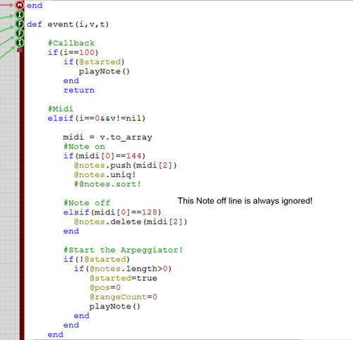

I don't yet know much about Ruby but I did experiment a lot with the code.
The #note off line in Ruby is always ignored even though I've checked that the note-off MIDI is coming in correctly.
Even if I put illegal code in the line it's still ignored. How can this be?
I'd love to understand what's wrong here.

Sorry, it's the 2 lines under the # comment that are ignored and I can't see why.
Re: Simple Arp
Spogg wrote:Hi TheOm
It's the 2 lines under the # comment that are ignored and I can't see why.
There's two ways, externals send a midi off. The one according to the midi specification is 128 (note off with reported velocity at key release). That's looked for here.
Some manufacturers take another path and simply send 144 with velocity 0. This is not a specification, so if you have an external that sends this, it won't be recognized by the arp.
You can try if it is the case here by changing the following code:
if(midi[0]==144)
@notes.push(midi[2])
@notes.uniq!
into this
if(midi[0]==144)
if midi[3] == 0
@notes.delete(midi[2])
else
@notes.uniq!
