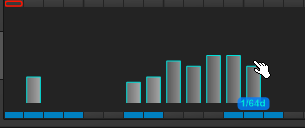

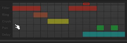

Hello everyone! Here's a question I have to knowledgeable people.
I want to make the effect like dblue glitch. The bottom line is this:
There are some effects (reverb, bitcrush and others)
How to create a grid of 32 steps, which will be specified when you turn this or that effect, and the other grid will serve as a field for drawing the envelope that will only work at a time when I will show and let the filter or control the amount of delay to mix.
Naturally tempo-synched.
Or even just a grid of 32 steps, which you can specify when to send the value "True" and again when it returns "false"
Maybe there is someone scheme which can be modified, I am for team work!
I'm sorry if misspelled, I do not know much English)

you can modify my stepsequencer for this, it has already all the sync stuff you need
viewtopic.php?f=3&t=1001
i did this kind of things in reapeat x, there are various ways to do it but its always the same scheme, store values (on/off - selections - parametervalues...) in an array and iterate through it in whatever speed you want...
