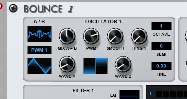

Holy Shi. Spogg i need ur help here. Its the oscilator connected to Normalize making this noise i had this trouble before with this thing. It makes this disted sound. Realy crap.
I was going inzane on this sound. And found out the problem is the normalizer.
So u need to connect something else there.
And inside this osc knobs. Its wierd to. Its 512 size there and end out in 256. Hmm i will check thoose osc knobs more to understand this. this is strange. Not uch make sense here.
It seem like ur trying to make a moprh? some how?
I have a morph in ruby working 100% + 4 diffrent pwm modes.
I did get help by nubeat for this module so i cant just give it out like this. If u ask nubeat about the morph and told him i sent you. Mybe u can have it. And do something.
But that thing works. 2 knobs for editing the waveform. And then PWM i will show u an image.
Hmm Mybe i dont need this tool
Mybe its better using that one O: This makes all u need
:D
But im not sure if nubeat wana give it out like that just.
Tlk with him mybe give him a little donation and he will give u
I also have a ruby keyboard form him u load BMP files and it works like the pro ones
hehe
