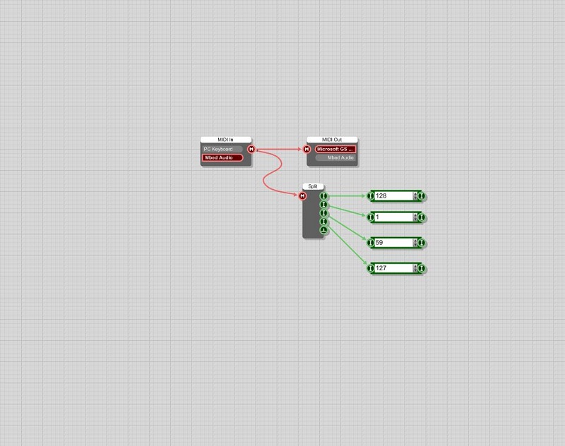

Hi all,
I saw an interesting video of a USB slingshot on the Mbed site here http://mbed.org/cookbook/Slingshot, and it brought to mind the demo done way back with flowstone and a gyroscope tied to a synth. Although I was initially looking at the USB keyboard and Mouse emulation, I also was happy to see a USB Midi implemented as well!

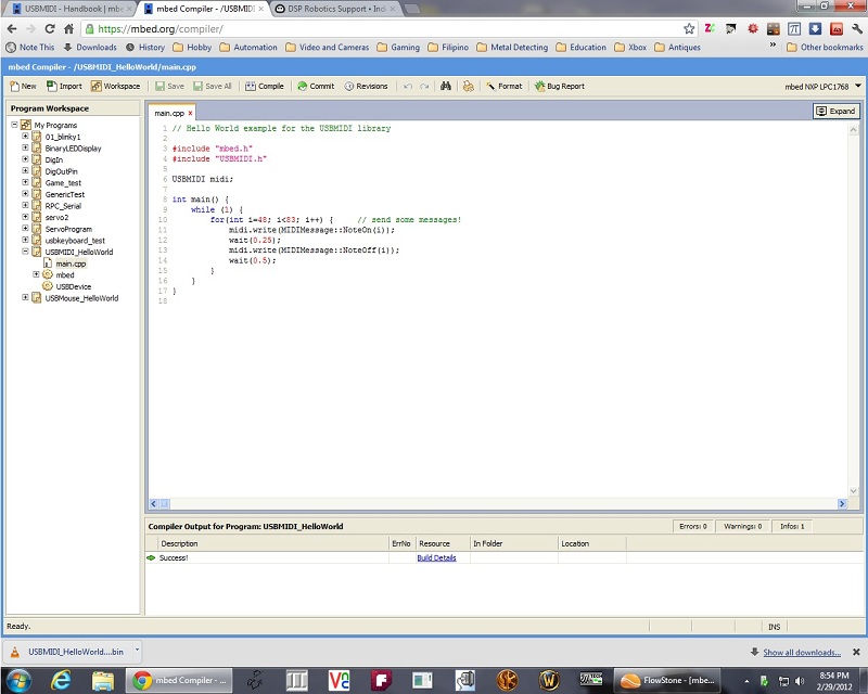

I thought this may be of some interest to folks here, particularly anyone with a music leaning and who may be thinking of building a hardware synth around Flowstone or something. The libraries can even be used for normal usb keyboard or mouse emulation as well. The screenshots I've attached are for the USBMidi library functionality. Basically, it works out of the box. Run the USB Midi demo located on the Mbed site here http://mbed.org/handbook/USBMIDI, and the Mbed Audio MIDI device is now an option in Flowstone in the MIDI IN and OUT primitive. The demo basically cycles through code 48 through 83 over and over. It does illustrate something that may be of extreme interest to folks here, particularly Synthmaker folks. I could easily see this Mbed chip being used to build a custom keyboard. The interesting thing here is the flexibility of designing your own hardware. With this hardware, you could basically incorporate USB keyboard codes and Mouse movements, along with the note generation into a custom synth. I'm not a music guy, so I am unsure whether this hardware would be of interest to anyone. Theoretical Music machine concept: HTPC with Digital Audio as a computer running Flowstone, an LCD with the Synth Visuals, a hardware panel with various custom switches, knobs, sliders, etc linked via an MBed MIDI interface.... Hmmm...

- Screenshot of Flowstone Midi test code
- capture.jpg (128.03 KiB) Viewed 20033 times

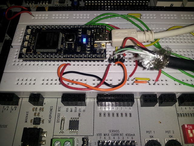

- Snapshot of MBed wiring
- mbed .jpg (109.13 KiB) Viewed 20033 times
- Picture of Mbed with USB cable
- 20120229_210048 - Copy.jpg (144.16 KiB) Viewed 20034 times

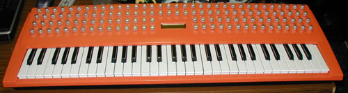

Actually, it's not hard to implement the real Midi Protocol on any Micro, I've done it years ago on an AVR.
- nachher_klein.jpg (45.62 KiB) Viewed 20029 times
