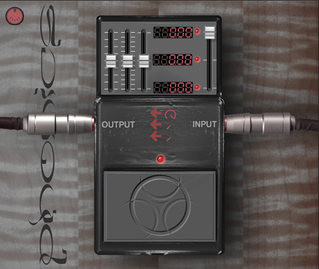

here is GUI-
It has 3 lines,
so you can play a chord.
Hope you like it,
I'm glad to get this working.
It sounds pretty good IMO.
Hope it gets tucked away in ur VST folder.
There is 1500 samples of delay,
but it seems responsive enough to run an
instrument through.
Cheers, Nick

Postby nix » Thu Nov 22, 2012 1:16 pm
sorry there was a bad graphics bug-pls redownload-I have edited the original post with new link

Postby nix » Fri Nov 23, 2012 6:08 am
Hope you find a use for it Phil,
it still has something wrong with the cc implementation in the sliders.
The version that is up is quite crashy,
but you can check the sound anyway.
It's better now, I'll squash the bug entirely before upping a new file.
Thanks for the compliment on GUI,
finally I have my own algo to put in this skin.

Postby trogluddite » Fri Nov 23, 2012 1:07 pm
Looks great nix - and the weekend is here, so I can have a little play!
Re: the CC in the knobs. If you are using the stock FS3 sliders, there is a bug in the code of the knobs (reported) that makes the CC and VST presets/automation "upside down" so that it fights with the GUI control. You can get a fixed version HERE.
