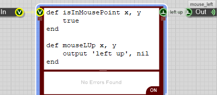

Then you need to go to the top layer. The top MGUI, to be precise. Here we add a wireless module. It contains simple code to catch a mouse up and send a trigger.
This works, because a mouse up event doesn't vanish, if it isn't handled on that layer. It will be transmitted to all layers that are connected by the MGUI's yellow "V" link. All of them build a chain, with the top layer MGUI being the last to receive that unhandled mouse up event. It catches it and sends a trigger, and each RubyEdit receiving it will release the mouse. It isn't harmful to release the mouse when it was already released by another RubyEdit.
