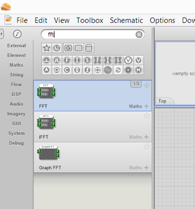

It really depends on how you want to process the data. When you want do just process 2 waves and then store/playback the wave you can use the FFT / iFFT primitives from the toolbox for this.
When you want to process live (output process results directly), you can use the Stream-FFT project (latest version is 11a):
viewtopic.php?f=4&t=1510&start=60#p6660
In both cases you have to FFT both (carrier / modulator) waves, multiply the spectrums and finally iFFT the spectrum to get back to time domain. The stream-FFT project file has basically all modules you need for that. You would just have to connect it in the right order. But makes only sense when you really want to do it in realtime.
