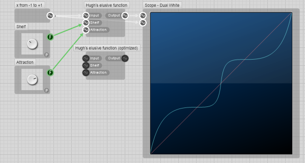

Hehe, that's indeed a very specific requirement. Here is my proposal (although, like Spogg, I have no clue what it possibly could be good for
Hugh's elusive function.fsm- (14.45 KiB) Downloaded 929 times

OMG!!
That is perfection Martin
I did make a start myself this morning with some DSP (honest!), got a quarter of it looking something like, but I guarantee I could spend a month on it and never get it this good (bitmasks and all) nor as streamlined. Thank you .. yet again.
