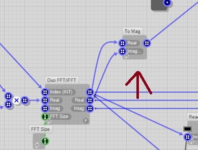

Does anybody knows how to make from mag to real and imag? It would be opposite from this?

The schematic contains both real/imag->mag/phase and mag/phase->real/imag conversion modules. Just check in the module called "components".
Note that both amplitude and phase information are needed to reconstruct the complex number properly.

KG_is_back wrote:The schematic contains both real/imag->mag/phase and mag/phase->real/imag conversion modules. Just check in the module called "components".
Thanks!
I am trying to make FFT limiter. I tried it by converting real and imag to mag and phase, then limit the mag, and convert back to real and imag. Problem is that it gives me some echo in background. Do you, or anybody else knows how to fix that?
