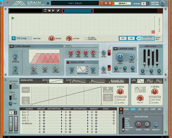

Nice tips there Spogg! i recently upgraded my Reason daw to version 10, it comes with a granular sampler "Grain Sample Manipulator" it is one of the best granular synths i have ever played, you should give it a wee hurl if you get the chance m8, lovely! great at getting some very usable sounds really fast just from dropping any old sample onto it and tweaking a little! here is an image of it -
Cheers for the article
Best regards - Jay

Thanks Jay!
Great products like Grain highlight the difference between my hobby-grade work and proper professional output. I still have fun experimenting with various techniques though, and often a commercial product has stimulated my interest in messing around to see what I can come up with.

You sell yourself short! The audio engine is pretty much on par with grain. It's only the GUI, that makes it look unprofessional.

Thanks tulamide!
I do try to make my stuff sound as good as I can.
The GUI is always my Achilles heel but also we don't yet have drag-and-drop and I do think that would really improve usability.
