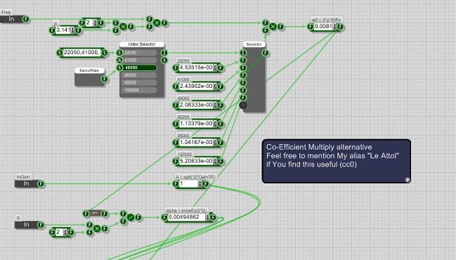

Anyways, for a co-efficient You need to set up an index selector and have all of the available sample rates (so that Your product is scaleable). Then use the sample rate primitive to select and then get the int variable and in the same semantic order work out the math:

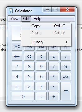

and then to copy that value just hit edit -> copy:

Here is an image of that alternative division with the relevant values:
