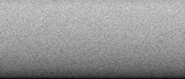

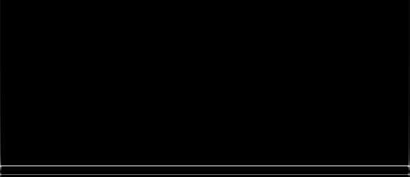

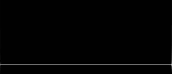

Ok, so I spent the day implementing this, I looked over at FS first, but coming from a traditional coder point of view it looks quite tedious to implement there. I also looked at Protoplugin but couldn't figure out how to sidechain it. So I ended up using Harmor to export the FFT in high-precision mode, and created the algorithm for the pixels per each column to morph between. It worked as I expected, but I need to turn up the particles further in number for an even cleaner transition (I used 40,000 particles). I wrote it in C# and just let it process.
Here are the sources:
SourceA
SourceB
SourceC
SourceA
SourceB
SourceC
- eternith15

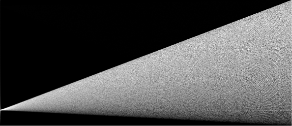

And here are the morphed results:
SourceA 1 Partial to SourceB 2 Partials
SourceA 1 Partial to SourceC Noise
It seems to morph anything pretty well so far, these are just the basics. I'll put up sounds samples likely tomorrow.
