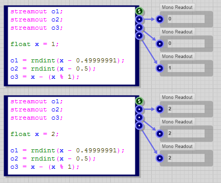

Postby Nowhk » Thu Feb 18, 2016 2:31 pm
MyCo wrote:That's not what I meant, try this to see the difference:
Code: Select all
streamout o1;
streamout o2;
float x = 1;
o1 = rndint(x - 0.49999991);
o2 = rndint(x - 0.5);
:shock: Both output the same here. x=1 output 0 (which is "wrong";), while x=2 output 2:
rndint.fsm
(1.57 KiB) Downloaded 1360 times
instead, using x - (x % 1) give to me correct result. Am I wrong somethings other?

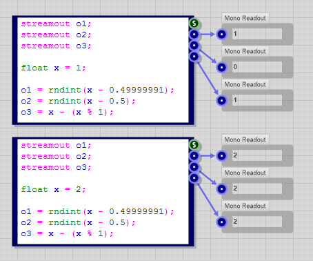

Postby MyCo » Thu Feb 18, 2016 2:39 pm
Seems to depend on the CPU:
MyCo

Postby Nowhk » Thu Feb 18, 2016 2:42 pm
MyCo wrote:Seems to depend on the CPU:
:o :shock: Yes, but I can't trust in different CPU 8-)
So I'll keep (until I'll upgrade to last version, where int() should floor correctly, I hope) x - (x % 1) :twisted:
