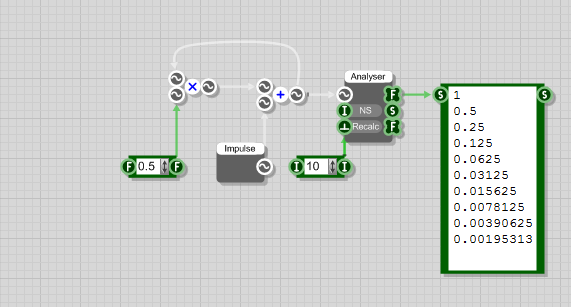

I think it has to do with the feedback topology and the way how FS evaluates loops. The following three examples illustrate the point.
The first schematic shows a loop with a gain factor 1/2 and a unit delay. The output shows a geometric progression as it should, where each sample has half the value of the previous sample. The Impulse primitive is there to start off the series.

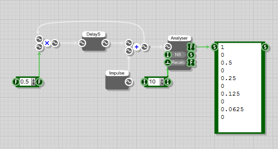

So far so good. Now consider the second schematic: still a loop with gain factor 1/2 and unit delay, only the order of the two primitives is reversed. You would expect the same result, but it is not so. :o Apparently there is a 2 samples delay in the loop! That reminds me of tor's finding, where a trivial change of the order of operations led to a different result.
In the next schematic I have removed the unit delay from the feedback loop altogether. This is something that should not be permitted, however FS somehow adds a unit delay into the feedback path and the result is the same as in the first example. :?
Now you could argue that examples 2 and 3 are consistent, but then example 1 does not fit in. (I prefer to think that example 1 gives the expected result while 2 and 3 do not.)
Okay, so in tor's filter schematic there are at least two feedback loops which behave in a similarly uncontrolled way. I have spent quite some time experimenting with unit delays inserted at various places, however I have not been able to get it right. So my conclusion is to avoid wiring loops in FS, as it can lead to unpredictable results even in very simple cases (refer to above examples). If you must have loops, use code. The stages 0 to 3 offer some control which is missing when only wiring primitives.

the manual states that any feedback wiring of stream/poly automatically makes a one sample delay. so in the examples with the delaymodule one should actually get two samples delay. so your example loop2 and loop3 is as one should expect. but example loop1 is the mysterie loop. it clearly shows there is some inconsistency in how the interpreted code is generated. this inconcistency makes it impossible to make designs with a predictable result. and the more complex it gets the harder it is to debug.
as FS do not provide all necessary double word upcodes in asm to do this and the code module does not provide any double word functions it is impossible to do this with code.
