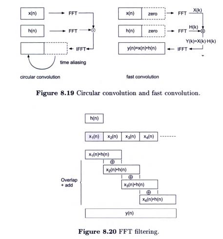

MyCo, FFT and IFFT are the same size. Before you do the FFT, you fill only half the frame with stream values and zero pad the rest. After convolution and IFFT you get a full frame back. Then you have to overlap add with the adjacent frames with 50% overlap. The figure below from the DAFX book illustrates the process quite well.
- FFT_convolution.png (102.14 KiB) Viewed 39076 times
Re: Stream FFT and iFFT
OK, when I understand that right, we just need 2 parallel running FFTs in our system. The second is 1/2 Buffer delayed. That's like the current setup does it already. I'm just wondering what happens with the window. When I apply the window to 1/2 of the Frame, the other half is zero, then I'll probably need another set of 2 FFT/iFFTs that compensate for the window borders (1/4 and 3/4 of the Framesize delayed).

As long as you stick to rectangular windows, 2 parallel FFT/IFFT will suffice for the filtering exercise. Demo attached. I have added a "half square" window function for the signal zero padding. The thing is you have to zero pad the FIR filter coefficients as well, so that involves some back and forth IFFT/FFT etc. which, however, can all be done in green. Look inside the schematic for documentation. By the way, I noticed that the green and the stream FFTs apparently have different exponent signs of the twiddle factors, you might want to check and make it consistent if necessary. Anyway, I think we have a first application of the stream FFT!
