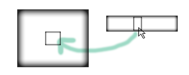

Not easy to explain..
I want the mouse icon to jump to a position, when click on the second control, so the icon will be at the exact place of the pad control 1. (if not the pad will change value before the user move it)
Don't know if this is possible. One problem might be to know which relative place or offset the icon will need..

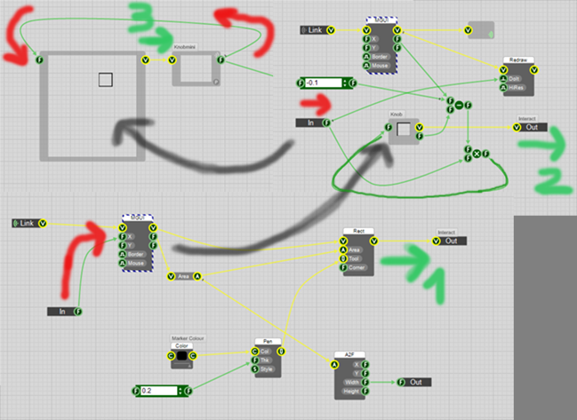

All my error with this was to use the prim x-y drag accumulate.. (but it works well for pad)
That's why i needed to move the mouse cursor. If you add another mouse area to it, each area would drag it.
But when you change area, you are in a very different position and the control will suddenly jump to another parameter.
It's possible to do another trick having 2 control, then transmitting the last value from one to another but it's a complex task with lot of wireless link to manage.
But it's even better to use a knob prim with ruby to make the control. In this case i erase the graphic from ruby.
Then i would use the hack function from Mgui prim (that are no more present in alpha but we could import the old prim) this make possible to move a module into another one. So i make it a cursor and the mouse area move with it. This way it's easy to have 2 mouse area that link to the same ruby control. And when we click on the other's one it doesn't reset the parameter but only increment it..
I do this on alpha so could not post an example, hope this image is comprehensible..
