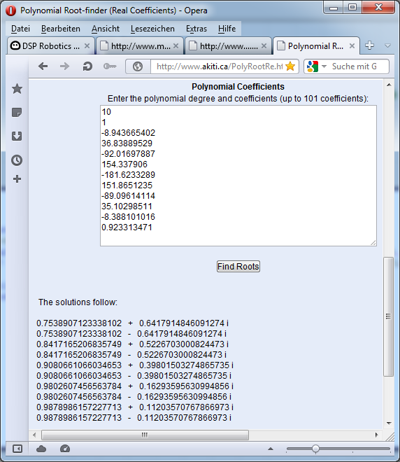

where the z1, z2, etc. are the poles of the filter. They are the roots of the denominator polynomial in equation (1). They can be real or complex conjugate pairs. There is a very useful root finder at http://www.akiti.ca/PolyRootRe.html from which we get the following result:
Observe that the ten roots come in five complex conjugate pairs:
Code: Select all
z1 = x + iy, z2 = x - iy, etc.
in equation (2) each such pair yields a section with real coefficients p and q:
Code: Select all
(1 - z1/z)*(1 - z2/z) = 1 + p*z^-1 + q*z^-2
with
Code: Select all
p = -2*x and q = x^2 + y^2.
