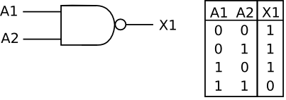

Hello gang,
Well I think I could use some help. I am trying to make a Nand gate that will mimic a Transistor Transistor Logic (TTL) Nand gate. Thats a hardware Nand gate that will pass Streamin data. I am not sure if the coding is right. Sometimes it SEEMS to work right and other times NOT. It should only work with values of 0 and 1, so I also coded a little module that will convert streamin data say from a Osc to just 0 and 1. Any help, suggestions, examples, etc., will be very greatly appreciated. Many thanks, BobF.....

Postby KG_is_back » Fri May 01, 2015 10:18 am
Code: Select all
streamin in1;
streamin in2;
streamout out;
out= 1 & ((in1 & in2) ==0);
