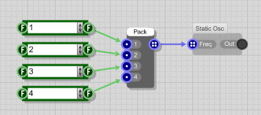

A question for the Ruby nerds out there: how do I create this simple function in Ruby:
Reason is I want to avoid unnecessary CPU load. The four inputs are basically constant, however they might change during stream excecution. I know how to code the Pack prim more efficiently in ASM, however that still involves unnecessary processing. When you have hundreds of packed data inputs in your schematic it does make a difference. :mrgreen:

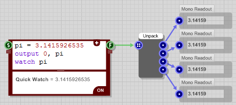

Thanks guys. Yeah, that should be possible, although I was hoping that there would be an easier way. Like using the .pack("f") method or something. The inputs I have in mind are not stream data, they are more like triggered data. Sort of green, but with the four SSE channels being different. Like this:

Ruby's pack method is not the same as Flowstone's pack prim. In Ruby, .pack is just a format converter. You can get a string of 4 values, but the string is not guaranteed to be contiguous in RAM, nor that its address is divisible by 16, etc.
Re: Packed data in Ruby?
Postby martinvicanek » Sat Nov 28, 2015 1:07 pm
adamszabo wrote:Why dont you do the packing in assembly and only use stage0 for that? Then I believe it will be only executed at the start and should not use any more cpu?
Yes, actually that's what I do. The drawback is if I do want to change the input I have to interrupt the audio stream to trigger stage0.
tulamide wrote:Ruby's pack method is not the same as Flowstone's pack prim. In Ruby, .pack is just a format converter. You can get a string of 4 values, but the string is not guaranteed to be contiguous in RAM, nor that its address is divisible by 16, etc.
Ah, I see. Probably the issue is not so much about generating the 4x32 bit sequence within the Ruby module but rather about getting it out transparently. We have only a small set of data types that we can use for Ruby output, and there is some implicit conversion taking place. For instance a green float output will provide 4 copies in single precision (even though internally floating point numbers are represented in double precision).
Postby tulamide » Sat Nov 28, 2015 2:37 pm
martinvicanek wrote:Ah, I see. Probably the issue is not so much about generating the 4x32 bit sequence within the Ruby module but rather about getting it out transparently. We have only a small set of data types that we can use for Ruby output, and there is some implicit conversion taking place. For instance a green float output will provide 4 copies in single precision (even though internally floating point numbers are represented in double precision).
Yes, Ruby uses whatever the system provides, for example double precision floats. But Flowstone uses single precision in green and therefore converts any outputs from Ruby to green. I think this is also documented somewhere in the manuals.
To get a series of 4 different values in a certain format, you have to use .pack(), just as you assumed. But, the result will be a byte string. This string is a bit like the mem prim, but Ruby does not take care of the contiguous data requirement, etc. So, you have a byte string, whose content may be in different locations in RAM. That invalidates it for use in the unpack prim.
Btw.: The green to unpack link is a convenience, too. In the background Flowstone does a conversion of the data (it reserves a contiguous memory block with an address divisible by 16, then copies the float 4 times to that mem block, and finally passes it to the unpack prim)
I really don't see an easier way than the one we already did. It is all there, just the block of memory (in Ruby it is a "frame") must be reduced to 16 bytes, and the input single values instead of arrays. You then get the memory address that you can access from assembler
