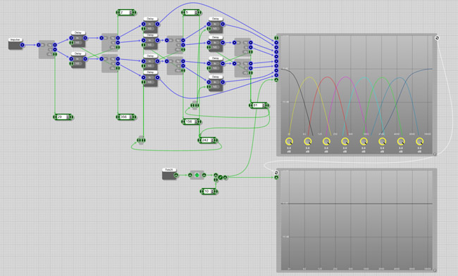

Please try the following .fsm :
Bandsplitter - Lipshitz-Vanderkooy - 8 bands (full) (650 pix).jpg (73.96 KiB) Viewed 103180 times
Try it for yourself. All 8 outputs are mostly phase-synchronous in the transition bands. The summed output is rigorously phase-linear. A square-wave in, leads to a reconstructed rigorously exact square-wave out. Quite unbelievable, isn't?
Latency is not zero. I think that a zero latency is physically impossible.
Latency depends mainly on the 1st crossover frequency, here 42 Hz, obliging a 356 samples latency.
Latency also depends on the 2nd, 3rd and 4th crossover frequency, here 96 Hz, 219 Hz and 503 Hz, obliging a 156 + 68 + 29 samples latency.
Consequently, the total latency is 609 samples, which is approx 14 millisecond when Fs = 44,100 Hz.
In case you want latency to drop below 10 millisecond, you need to set the 1st crossover frequency to a higher frequency, say 60 Hz instead of 42 Hz.
The Lipshitz-Vanderkooy band-splitter I am suggesting is consuming less CPU% than a 4th-order Linkwitz-Riley band-splitter that's incapable of delivering a phase-linear summed output. In case you want to insert a phase correction before a Linkwitz-Riley band-splitter, you will require a quite long FIR filter that's consuming a lot of CPU%, and anyway, for such long FIR filter to reasonably flatten the phase response between 50 Hz to 16 kHz, such long FIR filter will introduce at least 20 millisecond of latency.
Clearly, the Lipshitz-Vanderkooy band-splitter I've designed, is the best you can find (because it is transient perfect by nature), it is the most efficient (because of not requiring a phase correction), and it is exhibiting the shortest latency in the context of phase-linear band-splitters.
In case you dig into Stanley P. Lipshitz & John Vanderkooy "A family of linear-phase crossover networks of high slope derived by time delay", presented at the 69th AES Convention 1981 May 12-15 Los Angeles, you will discover that lowpass filtering by a double 2nd-order Butterworth, is not what Stanley P. Lipshitz & John Vanderkooy advocated for. Like everybody, they were in search of the maximal highpass monotonic slope that was attainable with a subtractive approach. They managed to find the 3rd, 4th, 5th etc. Butterworth lowpass filtering solution, that are all leading to a pseudo 3rd-order highpass slope, qualified by P. Lipshitz & John Vanderkooy as "high slope derived from time delay".
Unfortunately P. Lipshitz & John Vanderkooy dropped (or did not find) the "slightly oversized delay, double 2nd-order Butterworth" solution that I am applying here, that's leading to a pseudo 4th-order highpass slope. It should be named SOCDS-DB2. Slightly Over Compensated Delay Subtractive - Double Butterwoth 2nd-order.
John Kreskovsky paper dating back from 2002 got largely under-valuated. Possibly because few people had access to Digital Signal Processing. I am talking about John Kreskovsky paper entitled “A New High Slope, Linear Phase Crossover Using the Subtractive Delayed Approach”, Dec. 2002. If I remember, John Kreskovsky was the first to popularize the SOCDS-DB2 approach.
The slightly over-compensated delay subtracting scheme that's applied on a double 2nd-order Butterworth lowpass filter is probably the wisest choice, best balanced choice. And, as cherry on the pie, it is requiring approx. the same computational power than the ubiquitous 4th-order Linkwitz-Riley.
Unfortunately, below -35 dB, the SOCDS-DB2 attenuation curves appear to be non-monotonic. A Linkwitz-Riley crossover is slightly better on such aspect (because it is perfectly monotonic, but nobody expects perfection).
Unfortunately, in the transition band, the lowpass and highpass are not perfectly synchronous. A Linkwitz-Riley crossover is slightly better on such aspect (because it is perfectly phase-synchronous, but nobody expects perfection).
John Kreskovsky was not 100% clear about this. It didn't helped the SOCDS-DB2 approach to become understood, and mainstream. Meanwhile, the SOCDS-DB2 approach is transient-perfect, which means that a square-wave in, gets out as square-wave. And there, the Linkwitz-Riley crossover is disastrous. We are not talking about the Linkwitz-Riley being "slightly better". The Linkwitz-Riley crossover is a plain disaster on such aspect, contrary to the SOCDS-DB2 that's perfect on such aspect.
Please let me know if the SOCDS-DB2 band-splitter I've designed, helps improving the subjective quality of multi-band dynamics processors (expanders, compressors, limiters). And speakers crossovers also.
Have a nice day

This is just to tell that I managed to finalize a kind of "Band splitter with ideal phase" and some "minimum" unavoidable latency. Costing almost the same CPU% than a 4th-order Linkwitz-Riley band splitter that's a disaster speaking of global phase. See my previous post.
steph_tsf

Postby martinvicanek » Tue Mar 17, 2020 7:18 am
That's actually very clever! Although the bands are not quite linear phase when analyzed separately, their sum certainly is! And indeed, the design is quite CPU efficient. (Of course you can still optimize the actual implementation.) Moreover, latency is very low, given the low first crossover frequency. Well done, Steph!
One suggestion: I think you can improve the behavior in the lower dB range if you tune the crossover frequencies for integer delays so they perfectly match with the filters' group delays.

Postby steph_tsf » Tue Mar 17, 2020 10:03 am
martinvicanek wrote:One suggestion: I think you can improve the behavior in the lower dB range if you tune the crossover frequencies for integer delays so they perfectly match with the filters' group delays.
It depends what you mean by "improving", Martin. On one hand, speaking of a double 2nd-order Butterwoth lowpass, In case you adjust Fc for the low frequency group delay to tend to the fixed integer delay, you'll get a pseudo 1st-order or 2nd-order highpass slope in the transition band, not even the Lipshitz-Vanderkooy pseudo 3rd-order that's only attainable with a 3rd, 4th, 5th-order single Butterworth lowpass. On the other hand, speaking of a double 2nd-order Butterwoth lowpass, in case you increase Fc for the low frequency group delay to become significantly smaller than the fixed integer delay, you may achieve some weird, very steep highpass slope in the transition band, but doing so you will a) exacerbate the non-monotonic shape of the highpass amplitude curve (you will incur a rebound at -20 dB instead of -35 dB), and b) you will deteriorate the band-to-band phase synchronicity in the transition band. Trust me, Martin. The -35 dB non-monotonic highpass rebound is kind of clue, that the optimum balance is actually reached. The lowpass and highpass pseudo-slopes appear to be 4th-order in the transition band, and the band-to-band phase synchronicity remains very good in the transition band. You better promise no better. In case you promise better, people will complain about you and about the crossover structure, not delivering the promise. Journalists and Golden Ear experts will observe the non-monotonic highpass behavior, they will observe the slight phase non-synchronicity, they will graph the amplitude curves on a 100 dB scale, and consequently tell will tell the uneducated public, that a 4th-order Linkwitz-Riley structure should still be preferred. They will say that the ear is not phase-sensitive. They will not say that for most applications, a global linear phase and transient-perfect behavior, with minimal latency and minimal CPU% requirement, is preferred, by far, whatever the -35 dB highpass rebound, whatever the 35 degree phase mismatch in the transition band. Journalists and Golden Ear experts will try escaping the discussion, telling as conclusion that in case you are fool enough to pursue a global linear phase and transient-perfect behavior goal, you shall rely on some mythical FIR filter, frequency domain filtering, or time machine, that's currently under development, of course very expensive.
Have a nice day
