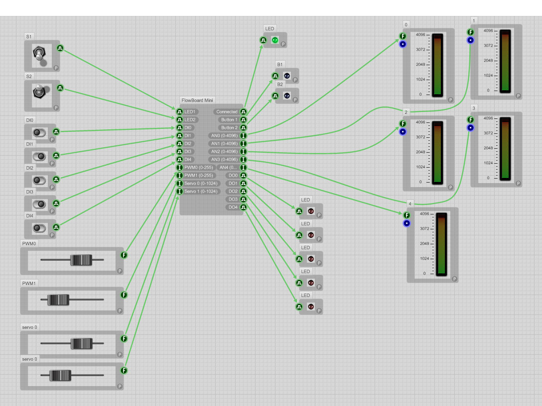

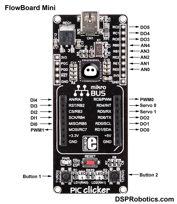

Here is our FlowBoard Mini project where you can get signals in and out of FlowStone using this low cost new PIC Clicker board from MikroElektronika from only $19 USD!
To program the blank board you need the free HID Bootloader app from here:http://www.mikroe.com/eng/downloads/get/1570/mikrobootloader_usbhid_v210.zip
Here are the instructions : http://www.mikroe.com/eng/downloads/get/1569/mikrobootloader_usb_manual_v100.pdf
It really easy, basically you connect the board via USB, connect using their Bootloader app (within the first few seconds), select the FlowBoard Mini.hex file from the source code files. Then press upload and your done, it will now be programmed to work as the FlowBoard Mini!
You can buy this board from here: http://www.mikroe.com/pic/clicker/
Here are the Beta files (Note: on the Beta version DI2,3,4 & DO5 are not implemented yet):

FlowBoard Mini HID.fsm- FlowBoard Mini FlowStone project
- (456.9 KiB) Downloaded 4570 times
