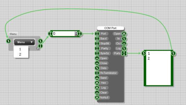

The Com Port Module has a Ports Output of available ports.
How does one take this array & use it with a Gui Selector module ?

If you add a text box connected to the com port out, it will show available ports,then you could feed this info back into a selector (in my example I used a menu) so you can now select one of the available com ports as input. Not sure if this is what you meant.

That's what i did in a simpler way;
Ports-->Selector-->Port
Much appreciated :)
