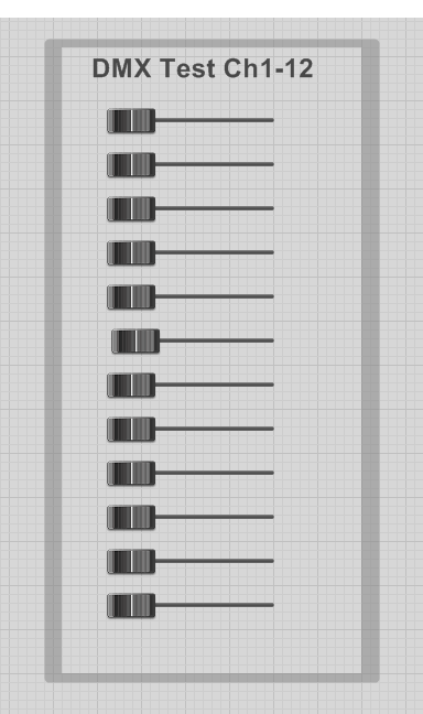

In this example we show how to use the new DMX module to control disco lights and stage lights.
You will need a USB PC - DMX interface with a FTDI UART chip, examples of these can be found here:
http://www.bitbang.co.uk/dmx.html
http://www.enttec.com/index.php?main_menu=Products&pn=70303
The DMX protocol is quite simple from the FlowStone side sending out a strings of Hexadecimal bytes (upto 512), each byte represents a DMX channel:
Here is a 12 Chanel lighting mixer:
DMX Disco Light Faders 12 clip.png (27.23 KiB) Viewed 95374 times
