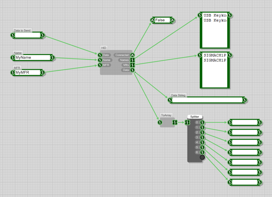

In the example we show you how to auto detect an HID device with a specific device ID:
HID Auto Detect clip.png (68.87 KiB) Viewed 93854 times
Connect you HID device (Games Controller, PIC Chip device etc.), FlowStone will give you a list of available devices and manufacturer names (MFR). Enter the names and MFR of the device you want to auto detect.
A good example of how you can use the FlowStone HID module is with the START USB board from MikroElektronika:
http://www.mikroe.com/startusb/pic/
This board has libraries for HID USB enabling you to make your own FlowStone interface board with external processing, analogue in and digital IO.
